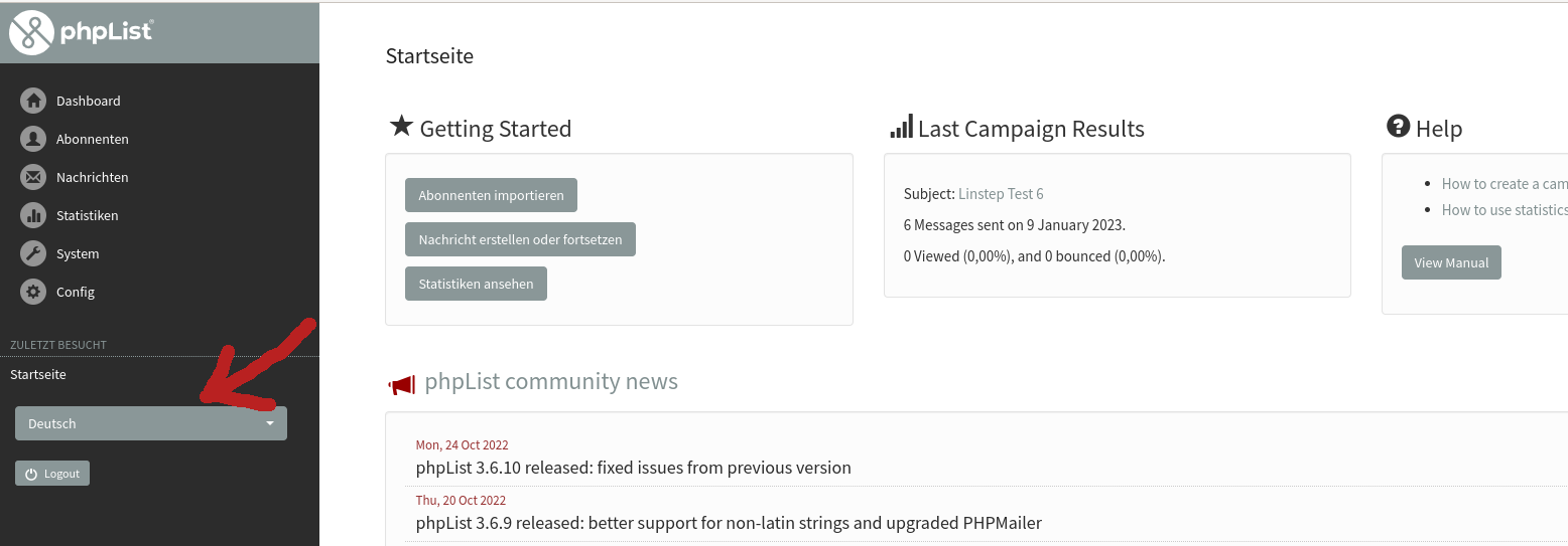

@mlanc The problem might be the one described here
The directions you provided were accurate and decisive, thank you.
In my case the language setting is ITALIAN.
But the problem - clearly - was the same.
I modified the admin/connect.php file and now it works even with the Italian language set.
GRAZIE!
