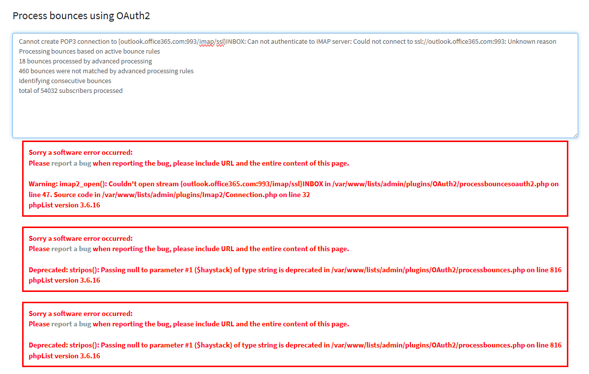

I have gone through the settings and the available documentation but I just can’t see to get OAuth2 and Office365 to work together. Any pointers would be greatly appreciated.

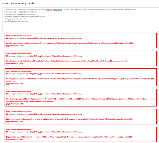

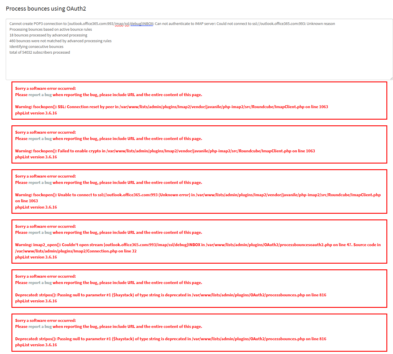

I get the following when running from the commandline. The web interface had the same information as the screenshot that was previously submitted.
sudo php /var/www/lists/admin/index.php -p processbouncesoauth2 -m OAuth2 -c /var/www/lists/config/config.php
[sudo] password for xxxxxxxxx:
PHP Warning:  Undefined array key "HTTP_HOST" in /var/www/lists/admin/init.php on line 621
phpList - phpList version 3.6.16 (c) 2000-2025 phpList Ltd, https://www.phplist.com
PHP Warning:  fsockopen(): SSL: Connection reset by peer in /var/www/lists/admin/plugins/Imap2/vendor/javanile/php-imap2/src/Roundcube/ImapClient.php on line 1063
PHP Warning:  fsockopen(): Failed to enable crypto in /var/www/lists/admin/plugins/Imap2/vendor/javanile/php-imap2/src/Roundcube/ImapClient.php on line 1063
PHP Warning:  fsockopen(): Unable to connect to ssl://outlook.office365.com:993 (Unknown error) in /var/www/lists/admin/plugins/Imap2/vendor/javanile/php-imap2/src/Roundcube/ImapClient.php on line 1063
PHP Warning:  imap2_open(): Couldn't open stream {outlook.office365.com:993/imap/ssl/debug}INBOX in /var/www/lists/admin/plugins/OAuth2/processbouncesoauth2.php on line 47. Source code in /var/www/lists/admin/plugins/Imap2/Connection.php on line 32
phpList - Cannot create POP3 connection to {outlook.office365.com:993/imap/ssl/debug}INBOX: Can not authenticate to IMAP server: Could not connect to ssl://outlook.office365.com:993: Unknown reason
phpList - Download failed, exiting
Web interface results…
