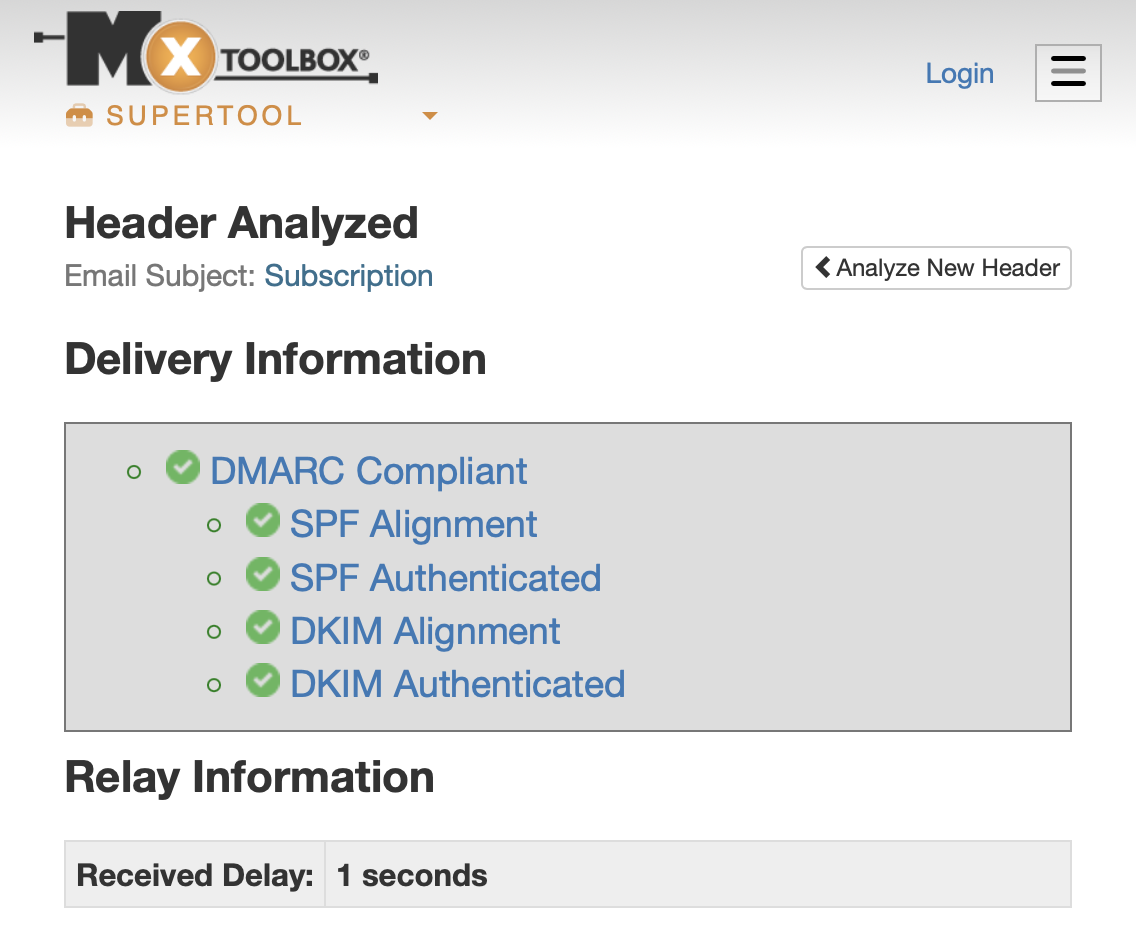

Heart Full Thanks for the workaround , Now i got 10/10 score in mail-tester, You saved me from hair fall :pray: :pray: :pray:
omg it solved my long time problem , “The DKIM Body Hash Not Verified” By mxtoolbox
Now the text and HTML emails DKIM are Perfect , YOU MADE MY DAY BY THIS WORKAROUND
