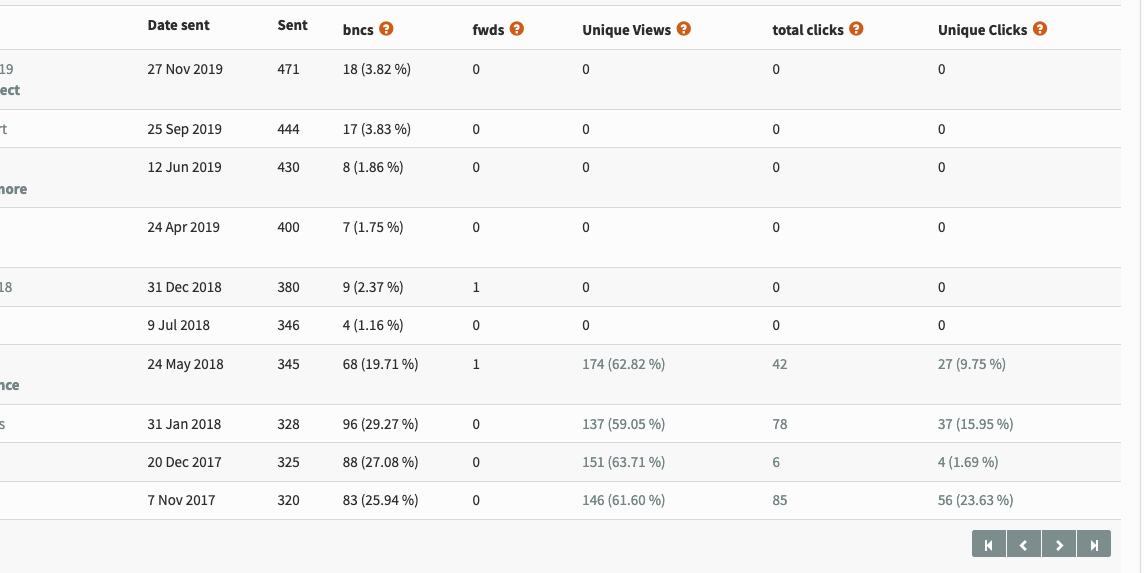

Whenever I go to the statistics section - more specifically, “statistics overview” - this is what I see:
I’m only attaching the page showing the abrupt change to zero - all the campaigns published after that, the last one being issued in March 2026, show a zero in every single column, except bounces (those have been addressed, and do not represent an issue at present).
@EQAR Possibly open tracking and click tracking have not been enabled, or were enabled then disabled.
To track link clicks this setting in config.php
define('CLICKTRACK', true);
To track opens, either include [USERTRACK] in the message or use this setting in config.php
define('ALWAYS_ADD_USERTRACK', true);
