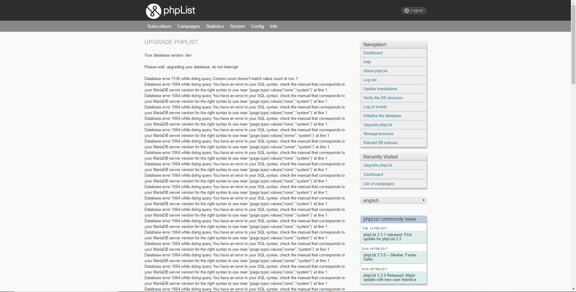

I have some additional information regarding the situation. Firstly, after uploading files everyhting seems to function properly, but the problem appears after database upgrade and after doing that i see some errors (see attached screenshots). Is this related to the problems i am facing?
@Vytautasber That might be the cause of the problem but I don’t have any suggestions on how to resolve it. Possibly the upgrade process does not work properly when the current version isn’t a real release.
It might be best if you don’t upgrade at all.
