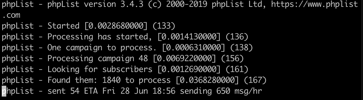

I just set up the cli script in order to try to send the campaign and I got this:
What do you think?
Thanks!
@titanve It appears that phplist cannot find the attachment for the campaign, therefore each attempt to send failed.

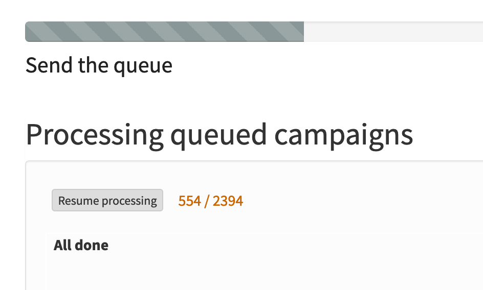

Hello @duncanc
After a while of processing this appeared:
I have my phplist site on Hostgator
What do you think?
Thanks!
Look at the Event Log page for any errors reported by phplist.
