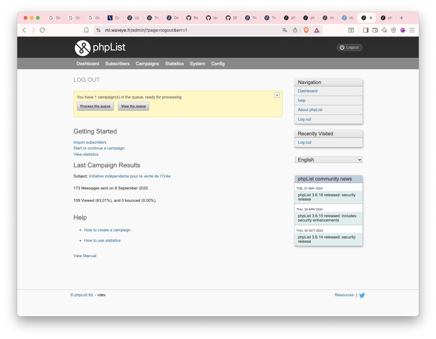

When I log in, I reach the dashboard page and I see the message to upgrade the database, but the site immediately logs me out.
I then upgraded the database from the CLI, but the issue persists — I am still logged out automatically.
I also tried version 3.6.14 (archive from GitHub), but the same problem occurs: I briefly see the dashboard, but then I am immediately redirected back to the login page.
When I revert to 3.6.12, I can log in successfully, but the dashboard indicates the database version as 3.6.16.

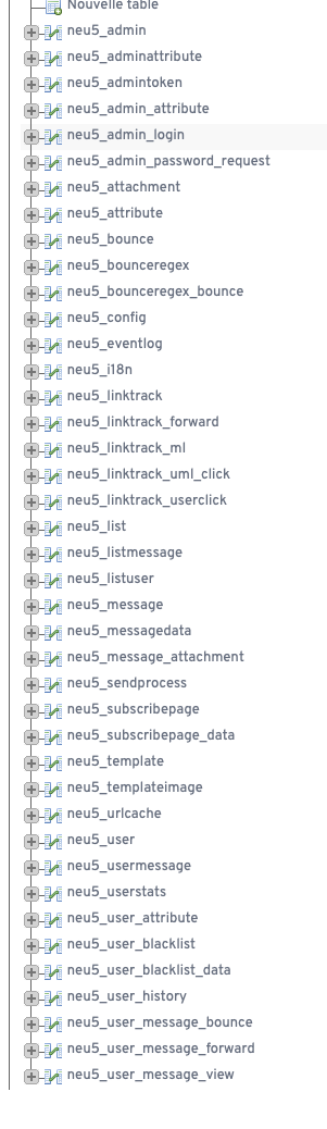

Release 3.6.15 added a table, admin_login. Check whether that exists, it shouldn’t as it will be created by the upgrade step which you have been unable to run.
Hi @duncanc
thanks but for your answer,
  • close , browser, remove cookie had no effect
  • I have admin_login table in my DB

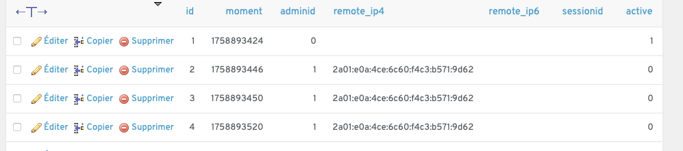

I had run the DB update from the cli , and when I log with 3.6.12 UI I got DB version 3.8.16
That’s strange the data in remote_ip4 column are ip v6 address
@fish I think that there is a problem with IP 6 addresses in that table, it is due to be fixed in the next release. You could install the release candidate version of 3.7.0 which should fix the problem. See Detect ip6 with admin login by michield · Pull Request #1084 · phpList/phplist3 · GitHub

I"I looked at the table after installing 3.7 RC2— the IPv6 address is in the correct column,
but I still have no access.
When I cleared the table, a new access added a line, but I still couldn’t log in.
I tried several logins; the last login is marked as active in the table, and the previous one changes to inactive status.

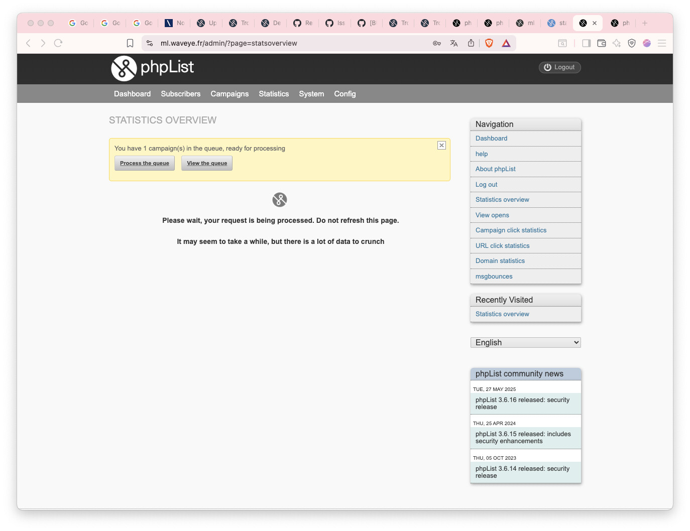

When I am on the dashboard, if I click on a link, I get logged out.
However, if the link is inside a button (for example, in the navigation bar or the process queue button), after logging in, I am redirected back to the dashboard page.

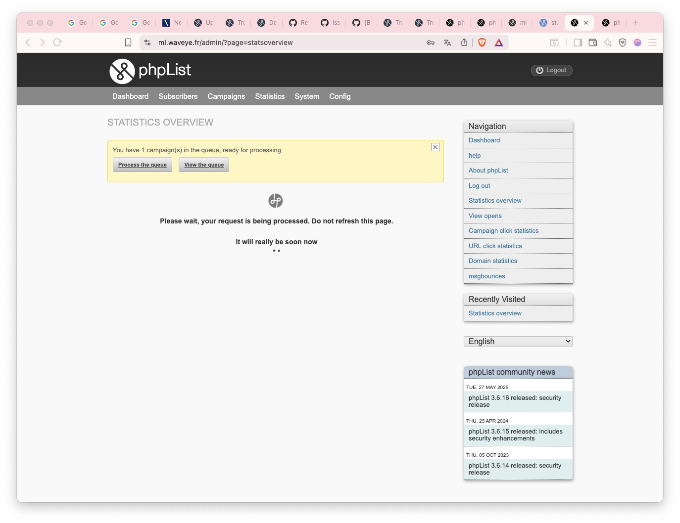

But if I click on a link that is not a button (the blue link), I get logged out. However, when I log in again, I am redirected to the page I wanted to access. This works correctly for example to go to the last campaign.
But if I click on the statistics link, I get stuck in a loop where the login page flickers too quickly to capture a screenshot

Also when logged-out the URL includes &err=1
That seems to be set in the function verifyCsrfGetToken() in file admin/lib.php and seems to mean that the php session is not working properly.
