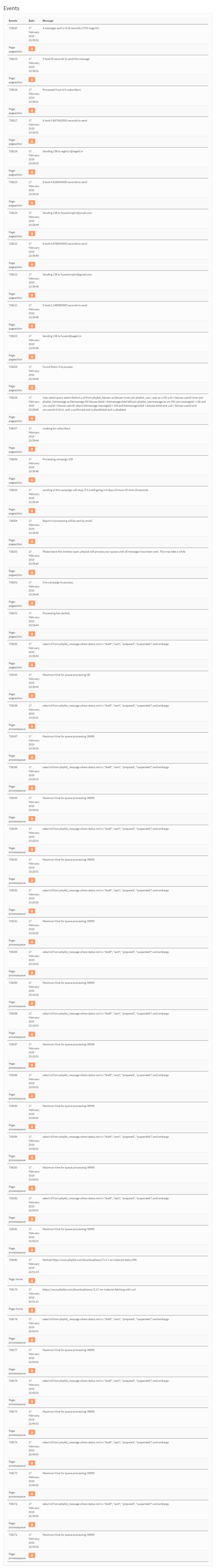

Here i attached event log screenshot for your reference. in that i send 1 campaign with 4 subscribers. It’s shows positive response.

@Husain I’m referring to event log records from the Amazon SES plugin. For each batch there should be an entry similar to this
Your screenshot shows that you were processing the queue in the browser, not as a cron job (the Page is pageaction instead of processqueue). Are you sure that all emails have been sent through Amazon SES and not by some other method?

@Husain the event log entries seem to show that Amazon SES is not returning any errors when the plugin sends emails. If that is the case then there is nothing more that phplist or the plugin can do, because the sending appears to be working.
