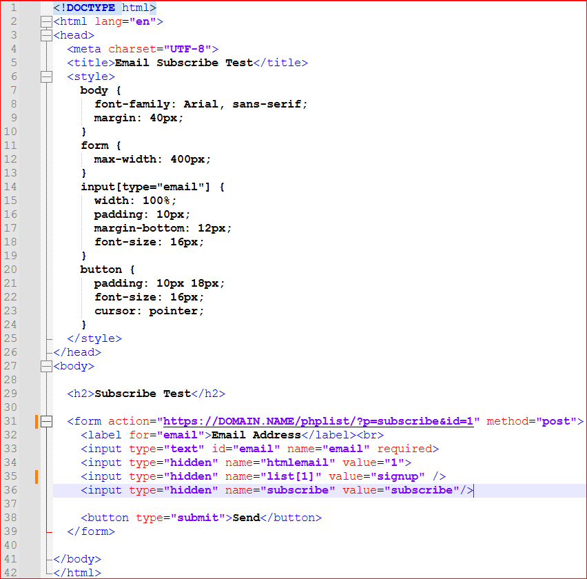

UPDATE
This is now working… After reviewing a page on this forum I found from 2016’ish, I found I was missing two input fields. I added those to my form, and bam - works like a champ.
The only thing I need to do now, is get the Ajax response to to populate on my website, and not send to the actual phpList page.
Thanks for the other set of eyes, and letting me speak aloud here…

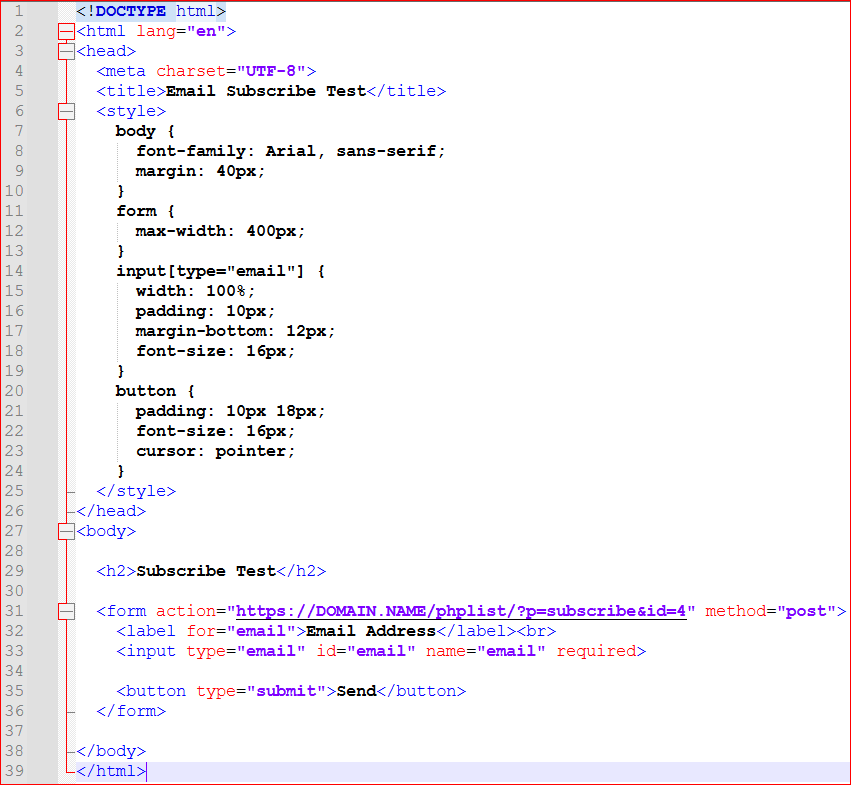

The biggest issue I am having is the subscription.. I am using the URL that is under “Config>Setting>Subscription Settings”, and have even verified that Subscribe link to what you have on your page. I am currently using: https://DOMAIN.NAME/phplist/?p=subscribe&id=4 (4 is the # of the “subscribe list” I want the person to be added to), which when I make a simple little test form (see code at bottom of this message), no matter what I do, it just takes me to a subscribe page asking me to confirm the email address I actually put in on the empty field when I clicked my send button, and wants me to check or uncheck the box to do HTML. Since the EMail address is actually getting there, I know the test form is sending something over. I even deleted all the subscribe pages for testing purposes, so there shouldn’t be anything that it dumps me to I wouldn’t think.
I verified that against what you have on your page: https://DOMAIN.NAME/lists/?p=subscribe&id=1, and according to what I am seeing, that should be working.
My test code is attached to this message, since it comes out all whacky when I post the actual code on here.
@WebmasterChuck Use the preformat toolbar button </> if you want to include code or html.
The id parameter is of a subscribe page not a list. You need to create a subscribe page that offers only list id 4 and follow the guidance on the page that I previously linked Creating a subscribe page | phpList manual
@duncanc - I got that figured out when I found the page on the forums here from like 2015’ish. My code now is this:
That works perfectly fine, and my only issues are below, which I am trying to read through forums, dox, etc., to figure out…
