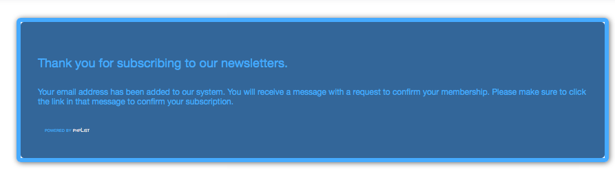

The problem arise for the “Thank you for subscribing our newsletter” page, for example, which is served by phplist, using its template.

I attach some screenshot (site is stil under construction) hoping to be more clear …
here is the phplist subscribe module in joomla. no problem
if you subscribe, you are directed here …
but this should be better …
playing with index.php, I can get directly here from the “If this is correct, please click the following link to confirm your subscription.” mail.
