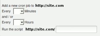

But if I use a virtual hosting with only a such “cron” options:
A cron job is not possible for autoresponder in this case ?
Sorry for my gtranslate english.
@AlexT If that is the only option for cron jobs in your virtual hosting account then you will need to try remote processing, as explained here https://resources.phplist.com/system/remote_processing?s[]=secret
That uses a url to run phplist, so can be run from your virtual hosting.
