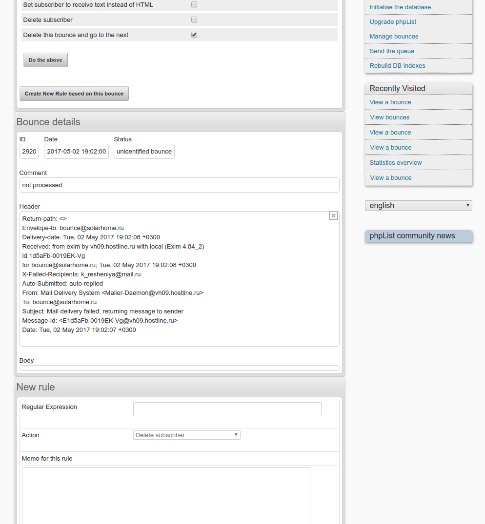

I was happy with phplist version 2.17. However, it stopped to load bounces - just showed the number of bounces, but not the bounces themselves.
I upgraded to v3.3.1. Now the bounces headers are loaded, but not the body. Also, user email is not recognized.
I don’t have rules yet, and they are not auto generated. Please see attached the screenshots.
Advanced BH is not activated, since I don’t know how to use regular expressions in my case. They do not work.
define(‘USE_ADVANCED_BOUNCEHANDLING’, 0);

PHPlist record for this bounce is in unrecognised bounces as follows:
ID 2920 Date 2017-05-02 19:02:00 Status unidentified bounce
Comment not processed
Header
CloseReturn-path: <>
Envelope-to: bounce@solarhome.ru
Delivery-date: Tue, 02 May 2017 19:02:08 +0300
Received: from exim by vh09.hostline.ru with local (Exim 4.84_2)
id 1d5aFb-0019EK-Vg
for bounce@solarhome.ru; Tue, 02 May 2017 19:02:08 +0300
X-Failed-Recipients: k_resheniya@mail.ru
Auto-Submitted: auto-replied
From: Mail Delivery System Mailer-Daemon@vh09.hostline.ru
To: bounce@solarhome.ru
Subject: Mail delivery failed: returning message to sender
Message-Id: E1d5aFb-0019EK-Vg@vh09.hostline.ru
Date: Tue, 02 May 2017 19:02:07 +0300
Body
I can see that phplist writes the failed address to this field
I don’t see it in the original bounce message.

I have no rules yet. How to create the rules for the bounces I have? I try to press ‘Create new rule from this bounce’ but just move to the rule creation fields. How to create the rules?
Why phplist put the bounces to the Undefined, in spite X-Failed-Recipients: are in the subscribers lists?

@leo2 Thanks, but I’m not sure what you are showing. Please can you copy a complete email from the POP3 account, so that we can see it before it is processed by phplist.
I need the complete email including headers, so you will have to “view source” or something similar.
I can not load attachments here. I can not copy full email body because it has links and I am not allowed to put >2 links here (I have 3 links in header only)
So you can download the example from here https://www.dropbox.com/s/4ncsvt687ji0vl7/bounce-example.txt?dl=0
PS. I opened the bounces in Roundcube, which I use very rarely. So, the header above were not from the bounce, they were from the message sent. I hope the txt in dropboxt reflects full bounce including its headers. There is that field X-Failed-Recipients:
But why phplist doesn’t recognize a user from that field?
@leo2 In Roundcube you can view the source of an email using the More button
Also, I have compared your bounce with one generated in my phplist installation and there is one difference that might be the cause of the problem. The bounce does not have a Content-Type header. That might cause the php imap module, which does the processing of a bounce email, to not recognise it, because it appears that phplist is being given an empty bounce body.
yes, I already found how to see the headers in roundcube. The file in dropbox has that headers.
How to fix that? I have actually 2 phplists instances, first is main and it sends emails. But it has some error in php imap and can not download bounces (no connection to pop mailbox), and it was same for v2.xx. So had to install phplist in another virtual hosting which can download the bounces to database. I wish I moved completely to that new instance, but they have limit for sending emails (100 per hour). Main hosting has restriction 10 per minute, so I use it to send emails. Both instances use same database.
@leo2 I was mistaken about the cause of the problem. I now think that it is a problem with the line endings of the bounce email when phplist processes it. That might indicate a problem with the mail server.
