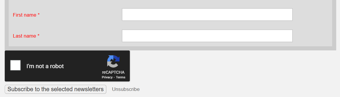

I was able to add recaptcha to my subscribe form.

Since enabling the recaptcha, the spam has stopped.

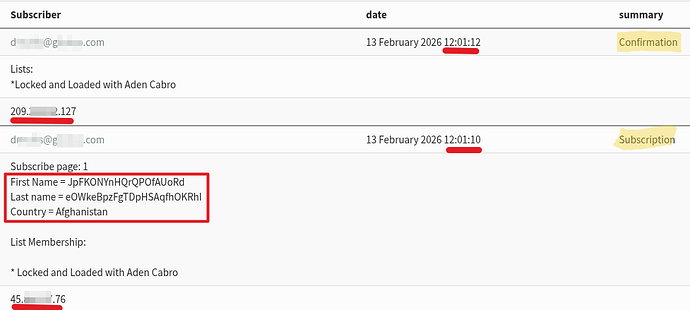

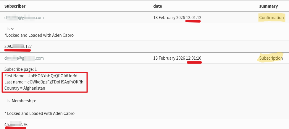

I think this screenshot from the last bogus account created before I installed that plugin is interesting. It shows the subscription was confirmed two seconds later from a different IP address. Thinking back to the spam complaint I got and the confirmations (which don’t happen for every subscription), I wonder if the bots are using real peoples’ email addresses and those real people are the ones reacting - confirming (but why?) or complaining about spam.
I don’t know why I’m trying to understand the motivation/intent behind this bad behavior, but maybe understanding the intent would help mitigate the problem. Maybe… :face_with_diagonal_mouth:

There is obviously some mischief in mind. But now I am happy, no more spam accounts since activating recaptcha v2. Thanks @duncanc!
