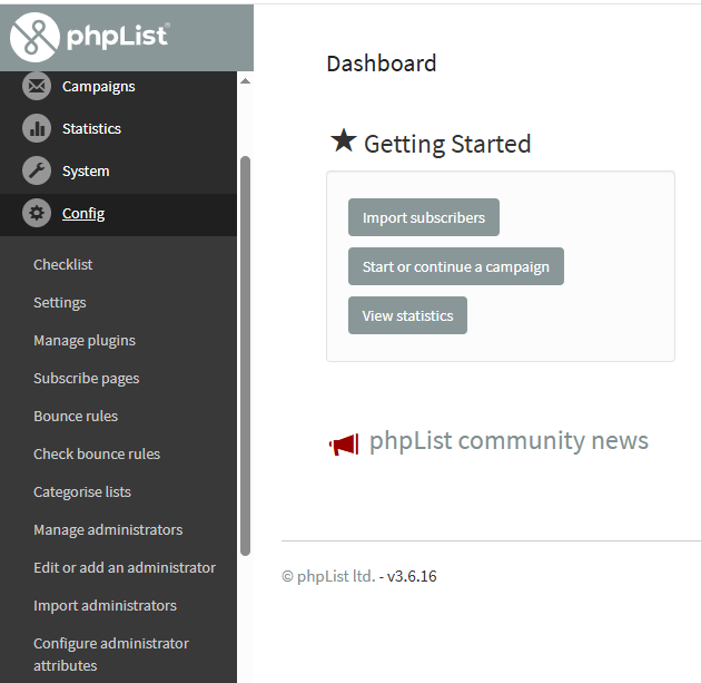

Dan, can you please help me! I can NOT find throttle setting on my php page
Explain it to me like I am an idiot. I have looked all over this thing. Am I suposed to be changng somethint in the acttual code somewhere?! HELP
I didn’t even get as far as you.
I can NOT find -throttle setting- on my php page
I have looked all over this thing. Am I supposed to be changing something in the actual code somewhere?! Can you please tell me where I am supposed to be looking? I will happily admit I am a moron if someone could please tell me how to find the settings so I can change them. please help. thank you
