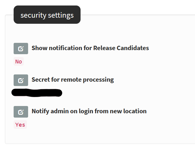

When I go to Config / Settings this is the security settings group:
There is no mention of RESTAPI on that page at all.
@ibPeter You have probably installed the wrong version of the plugin. On the documentation page plugin:restapi [phpList Resources] use the download URL. You appear to have used the link to the previous version.
